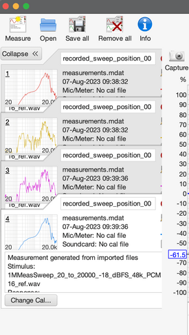

Is it possible to allow for longer measurement names? Often during an import these will be trimmed to 26 or so characters. I know it's not a trivial task since this might affect backwards compatibility of mdat files and cause some nasty graphical issues with legend in All SPL graph, etc.
A minor graphical thing - on MacOS (with the latest 5.20.14 version) the left sidebar sometimes goes underneath the graph and the icons are inaccessible. Clicking "collapse" twice doesn't change a thing.
What Mac hardware and OS version are you running when you see this problem? What's the screen resolution setting? Have you changed any of the font settings in REW's View preferences? I don't see this issue on various different Macs running Catalina to the latest Sonoma developer beta.
mdat is not attached, must be over file size limit.
I can't see anything wrong in the info windows. 4M measurements might be causing some memory issues (wild guess). You'll need to wait for John .
When I tried 2M measurements, 1/A worked, so I think you are on to something.

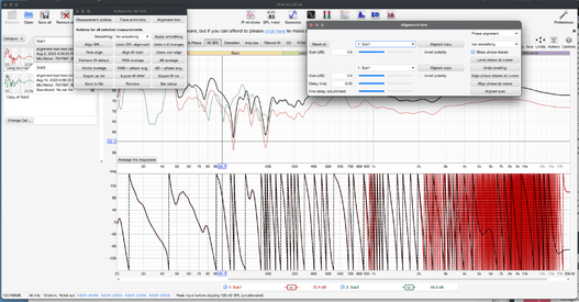

The Alignment tool seems to cause REW to hang on my Macbook Pro. It's using a lot of CPU power, and when I try to use the top menu REW becomes Not Responding in the Activity Monitor. I'm using the ea70 build. The macOS is Ventura 13.5. Any idea what could be wrong?
I've had the attached exception occur a couple of times now
That's a bit of self-contradiction in JavaSound. It includes the headphone port in the list of available audio devices but when it is asked to provide a name for the device it is saying actually the device isn't available after all, probably because it doesn't have anything plugged into it. I'll suppress the error.
Can you attach an mdat file with the two measurements you are trying to align and attach a screenshot of the alignment tool setup before the hang occurs, please? What is the alignment frequency?
In the help menu there is an option to generate a diagnostic file, please also attach the file that produces.
OK, here is an mdat with two measurements, and a screenshot at the point where REW is starting to hang. Unfortunately, the Help menu is also unresponsive, so no diagnostic files can be generated at this point. The selected frequency is 100 Hz, if it matters.

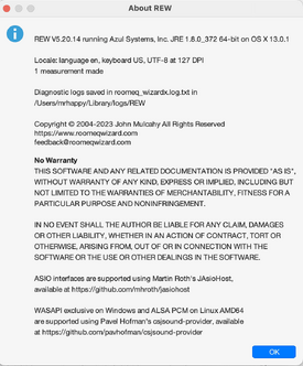

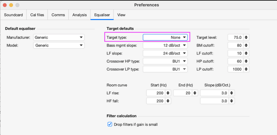

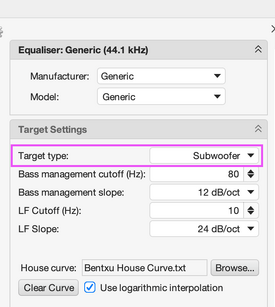

@John Mulcahy not sure if it is a bug or a feature and if it is a bug, if it has been reported.
When I set "Target Type" to "None" in "EQ Preferences" and then want to EQ with a generic EQ, it sets the target to Subwoofer. Needs to be changed every time. It does not seem to be picking up the Target Type preference.
Details in the attached files.
REW v5.20.14
2020 16" MacBook Pro 64 GB on Ventura 13.0.1
Screenshot EQ Prefs.png Generic EQ Screenshot.png REW Version Info.png Platform Info.png
Works as intended for me. The default target type in the Equaliser preferences is used for new measurements. Changing the default will not affect the target type for any existing measurements.
