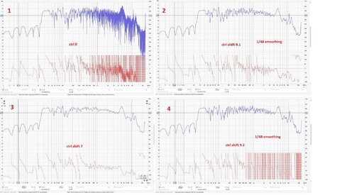

In the latest version, phase graph smoothing in the SPL window and smoothing in the GD window do not work correctly. If you disable smoothing and then enable 1/48, everything is correct. But if you turn on anything other than 1/48 and ctrl 0, and then turn on 1/48, the phase is not displayed correctly. And GD.
Not correct how? What are you seeing and what are you expecting to see? Do you have a file that shows the problem?

I took any graph, pressed ctrl 0, then ctrl shift 9, ctrl shift 7, ctrl shift 9. This is shown in pictures 1,2,3,4. Two right - smoothing 1/48.

  • Fixed: Changing smoothing from a fraction more smoothed than 1/48 to 1/48 did not apply the improved phase smoothing

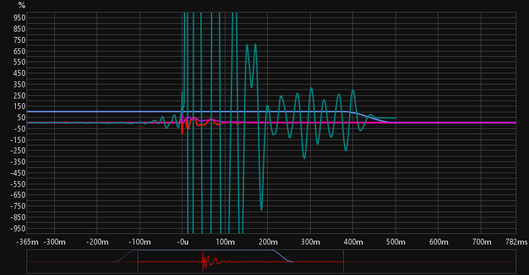

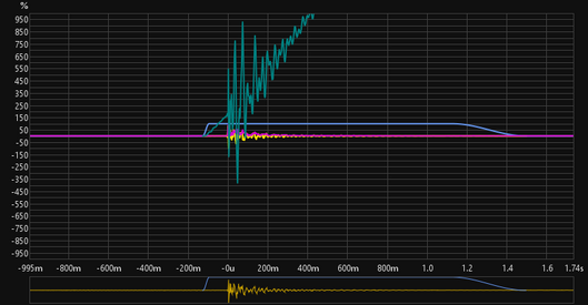

Has something changed about the way "Normalize step to IR peak" works? I could've sworn it never used to behave like this:
