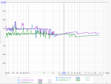

I get strange GD measurement results from speakers corrected with DSP, measured with timing reference.
On image are left and right speaker measurements with 2 different DSP what have different processing delay, this cause delay on mid frequencies.
What creates strange GD on higher than 3kHz? Is it DSP, soudcard, timing reference or REW math?
Image is from REW V5.40 Beta 101, lower lines measured with older beta 9x something.
