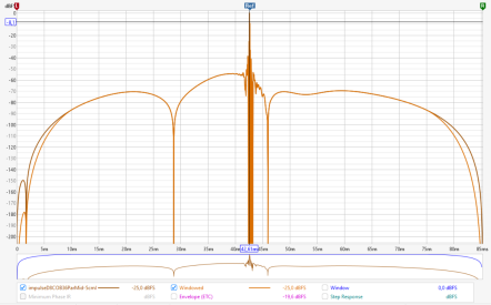

The change will be reflected in the Cumulative IR shift figure on the Info panel and in the title of the t=0 adjustment dialog.does REW report anywhere where the estimated IR delay is after it is applied?

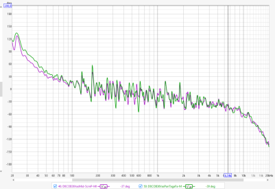

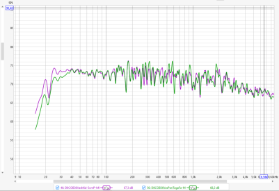

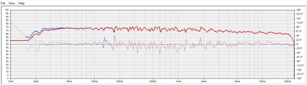

I made with DSP FIR filter to correct phase to 0 over full range but when I measure results phase is not corrected.
Yes the resulting measurement reports the filters applied but the measurement is not the one expected. May this be caused by wrong soundcard settings? Could be an acoustical problem? The speaker is mounted on an open baffle. I tried a filter manual entered by me but is the same, the measured with filters graph is looking like the original one.Which measurement did you select for Measure with these filters? It should be the one used when generating the filters. The resulting measurement will include a list of the filters used and the measurement they were obtained from in the notes.
Neither is likely to have any effect on your results. The measure with filters feature works as intended. Perhaps you could try connecting a loopback from the output to the input to eliminate any external factors and help isolate where the process is going wrong.May this be caused by wrong soundcard settings? Could be an acoustical problem?
