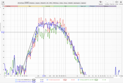

Is possible that REW 5.40 b 102 creats incorrect EQ filters on Generic Extended model?
Measurements with REW generated EQ in DSP did not fit with REW predicted response, difference is until 10 dB on some frequencies.
On my DSP configuration tool I did not see resulting response, I can only measure. How is possible to check are generated EQ correct?
I find on REW EQ is option "Measure with these filters" what make measurement with EQ filters applied to sweep signal, this give very close result with predicted response. So problem is somewhere in EQ filter text export and import to DSP or in DSP.
Do you export as text or biquad?
Is the sampling rate of the filter file export (biquads) matched to the DSP (e.g. 96 kHz, if you are using 96 in the 8C)?
EQ-s exported as text, no biquads, on DSP and on REW sampling rate is 96 kHz. If I compare EQ-s on DSP and on REW, they are exactly same, Q-s, gains and frequencies fit 100%.

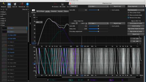

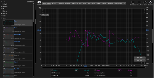

Hi,
thanks for all the great work on this wonderful software! I am using the Beta 5.40 102 right now.
I have a question about the expected behaviour of the alignment tool:
The phase trace of the alignment tool is not affected by the "shift and update timing offset" function.
As you can see in the attached images, the timing offset of the measurement was shifted afterwards so that the phasegraph is readable, but when opening the alignment tool, the phase graph of the same measurement has all these extra phase wraps. Selecting and deselecting the Checkbox "Remove time delay" does not really make a difference, I would expect the same result as shift IR to Peak of the first measurement. The same timing offset should then be applied to the second measurement.
Maybe you can help me with this?
The .mdat file unfortunately is to lagre with 67 mb to attach here, but I can send a cloud link to it in a pm if needed.
I do also have an other wish:
The implementation of the d&b audiotechnik tuning filters is great, it makes this software much more usable in a pro audio environment.
Is it also possible to implement the filter definitions of the Powersoft Amplifiers and make it possible to import the Filtersets as .iqb directly into Armonia+, basically in the same way this is already possible with d&b R1.
I would even be happy if this is only part of the professional license, as this is something mostly professional users would need. This would be huge for me bc it is always a lot of pita to convert between the different filter definitions and keep track of which manufacturer uses which definitions.
Updating the timing offset changes the offset setting on the measure dialog, it would affect measurements made after the timing offset was updated, it has no effect on existing measurements.
You could generate a measurement from the filter response using the option in the Filter tasks pane. It will be the same as the filter response you see in the EQ window.
