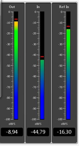

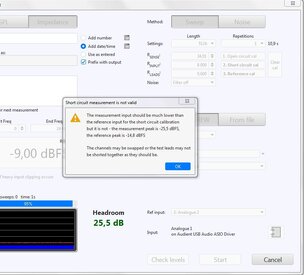

To measure the impedance, I spent an hour fiddling around connecting, unplugging the sound card, rebooting the computer, and taking calibration measurements to get through the 2nd calibration step. REW wrote that the entry level should be much lower at this step. There were such figures -15 dB, -25 dB. Then it became -5 dB and -15 dB on its own, and REW skipped me to the third step. But the difference is the same. Then something else changed and it became -6 -28. Then -6 -44. And so it remained. I was able to make impedance measurements. I did it for more than an hour, everything was fine. This happened to me many times, but I could not understand the reason. The equipment was not changed, no programs were launched. All input devices except inputs 1/2 of the external sound card are disabled. All output devices except outputs 1/2 are disabled. It is not clear who cannot agree with whom immediately, but only after an hour.
I don't know why those figures should be varying, but with the leads shorted the measurement input should be very low since it is connected to a short circuit. If it isn't then something is wrong.
