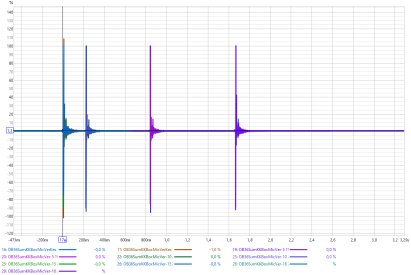

You should be able to right click on the measurement on the left and select offset t=0 directly for that measurement. Right clicking on the graph and selecting offset t=0 seems to automatically select the last selected measurement.Hi John,
When I try to align the selected impulse responses in Impulse Overlay screen using the Offset t=0 option, it seems REW chooses the IR to align arbitrarily. In my case, I want to align the blue impulse to the red one but neither is selected in the pop-up window. It would be great to be able select the impulse response to be aligned by either clicking it on the left legend or within the pop-up window. Thanks.
Cool, thanksYou should be able to right click on the measurement on the left and select offset t=0 directly for that measurement. Right clicking on the graph and selecting offset t=0 seems to automatically select the last selected measurement.

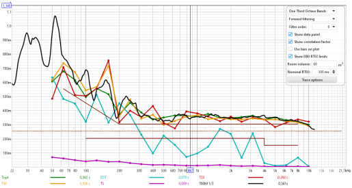

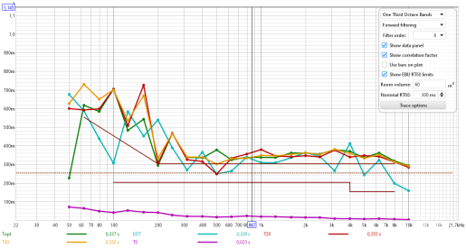

It needs to be generated on the RT60 decay graph to be visible on the RT60 graph.On measurements RT60 tab T60M 1/3 line is visible and existing only for measurement on what RT60 tab was first opened on current REW session

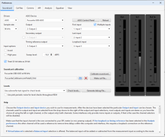

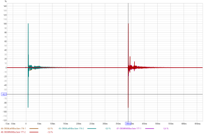

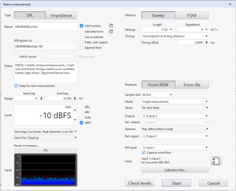

Can you attach the mdat? Is it as expected at 48 kHz? Have you set the Focusrite ASIO driver buffer size to a large value?I get strange results with 5.40 Beta 98 and Focusrite 8i6 gen 3 on USB ASIO at 96 kHz.
This was hint that helped to find the error, 3 output still did not give out the signal, after Focusrite driver update and settings reset I get it working and strange impulse delays are gone.... try making a measurement of output 3 to input 3 to check all is well with the loopback.
