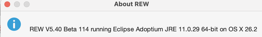

REW v5.40 Beta 114 running Eclipse Adoptium JRE 11.0.29 64-bit on OS X 26.2.

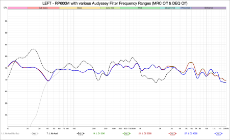

whenever I open any file and go to the All SPL graph, nothing is displayed. I have to actively select different measurements to make them appear.
As noted in my previous post, the All SPL graph is completely blank when I re-open the file and I have to click each measurement again for anything to display.
