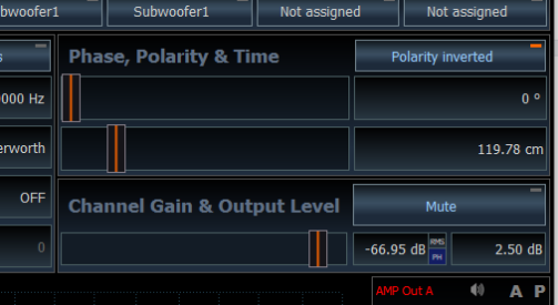

I wish to have phase shift simulation function in Alignment tool, same function with time alignment @John Mulcahy
How would that differ from what the delay slider does?
Phase shift is different from time delay. Here is the configuration in Audiotec Fischer, Helix, Brax or Match DSP
That doesn't tell me anything, sorry. If you are looking for an all-pass option then it would add extra settings (centre frequency, order) for little benefit (no benefit for most people). If you want something different please explain exactly what.

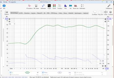

Minor UI bug - there doesn't seem to be a vertical scroll slider for the SPL view. I need to right click and drag it around. There used to be a slider here:
