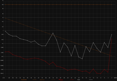

Hi John, I’ve encountered something that doesn’t really make sense to me. I’m using the stepped measurement feature to measure the IMD vs level for my DAC.
After running the measurement, I saved the current RTA stepped measurement graph to the main window. I only have 1 measurement loaded in the main window. When queuing the graph’s distortion using the API, I seem to be getting results that don’t line up with the graph at all.
I've attached a capture of my graph and the .mdat file. Below are the results from the API call.
According to the graphs, the TD+N (%) takes values between values between 1 and ~6e-3.
Likewise the IMD_SMPTE curve takes values of ~0.02% toward the left and bottom out around 5e-4%.
Below is the output I get when I query for the distortion values using the API. For IMD and TD+N, there are no values close to what is shown in the graph. The results would suggest a flat line for all the data. Would you happen to know what might be happening?
Stepped measurements are saved automatically when the measurement ends. If you are doing a manual save after that you are probably just capturing the last point of the step sequence.
hmm even without the manual save, the API still returns only the final value it seems.
For measurements obtained from sweeps, calling the "/measurements/{id}/distortion?unit=percent" endpoint works well to return the values in the units requested to plot the distortion graph in the main window.
Somehow this doesn't work if the graph is created from stepped sine measurements via the RTA.

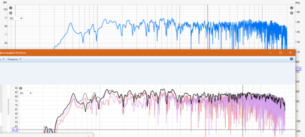

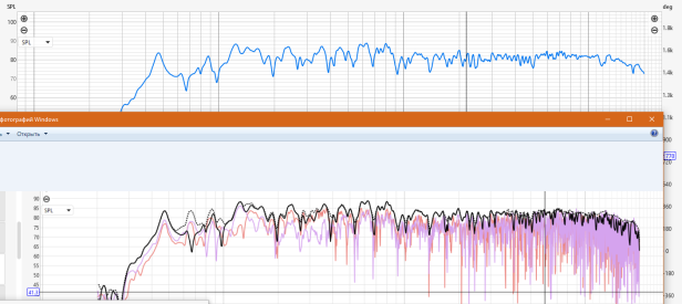

John, please explain what kind of smoothing I see as a sum when two measurements are loaded into the alignment tool without smoothing? Why, when creating the sum of two unsmoothed measurements, the result in the HF part is not similar to what I see in the alignment tool? There are two cases in the pictures. The result of the sum is not smoothed + the sum in the alignment tool. The result of the sum is smoothed to 1/48 + the sum in the alignment tool.
The alignment tool works with 96 ppo log-spaced copies of the measurements so that real-time adjustment is possible, since each log-spaced measurement has about 1k points rather than the typically 128k of linear-spaced measurements. Log spaced measurements are smoothed to half the PPO to prevent aliasing effects.

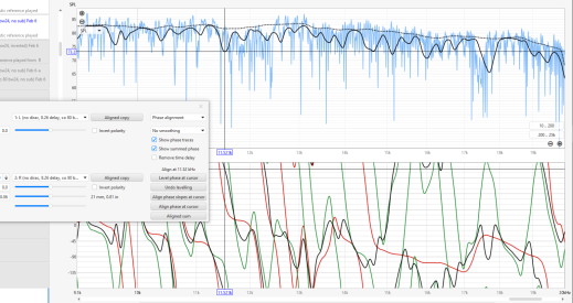

Got it. Thank you. If you look at the area around 12 kHz in the alignment tool, it seems that there are small peaks, the rest of the frequency response is beautiful, with no holes. But if you look at a section of about 12 kHz after smoothing 1/48, there is a big hole. And this pit is visible on the unsmoothed graph. So why isn"t it visible when smoothing 96 ppo?
I don't see what you are referring to or why it could possibly matter, but 96 PPO data is smoothed to 1/48 as part of the conversion to log spacing.
I increased the X axis. Consider a frequency of 11.521 kHz. In the top graph, the black solid line shows what the frequency response will look like if you add up measurement 1 and measurement 2. At the point 11.521 kHz you should get 73.2 dB at 96 ppo. The blue graph (unsmoothed) against a black background turned out when I clicked the Aligned sum button. I expected 73.2 dB, but got 82 dB. I expected a hole, but after adding it up there is none.
Further. In the section after 11.5 kHz to 12.5 kHz, the black graph does not show a hole. But after addition it is there (blue graph).
From 13.5 kHz to 15.5 kHz, the amplitude of the black graph changes so that it cannot be called flat. The actual sum (blue graph) is almost flat.
After 17 kHz, the black graph shows a shifted hole relative to blue. 17.7 kHz has 66 dB for black and 78 dB for blue.
It seems to me that such discrepancies between the expected frequency response and that obtained after actual addition should be important.
It seems to me that you are obsessing over acoustically irrelevant details. The graphical preview sums the 96 PPO log-spaced data. Smoothing is a non-linear process, so smoothed(A) + smoothed(B) is in general not the same as smoothed(A+B), though the differences are trivial at the frequencies of interest for alignment. Aligned sum uses exact trace arithmetic.
Often people make measurements when the microphone is not exactly centered between L and R. To get the sum without comb filtering, you need to align the two responses as if the microphone were exactly centered. At HF, plus or minus a couple of cm gives either flat summation, or a few holes and humps, which in reality do not exist. So that's my interest. To find the time alignment, I load the unsmoothed data. Therefore, I assumed that this method would give the greatest accuracy. After your explanation, I will know that Aligned sum uses exact trace arithmetic and will show more accurately all the details of the addition. Thank you.
Tip: Sum their MP versions.
