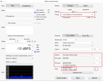

@John Mulcahy, I noticed this in the most recent build—it might be in earlier builds, also—and there is nothing in the change logs about this 'feature; how would the other 'channel' of what is essentially a mono mic be used as a loopback timing reference? How would the timing of the reference channel be different than the input channel if they are on the same ADC?

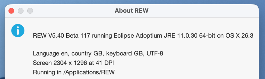

I used Chat GPT to talk through diagnosis. The summary below has been created by Chat GPT based on the ongoing chat I had with it. However, any unsubstantiated statements from the AI, I have put in a quote box (I have no idea if they are accurate, or just plausible speculation presented as fact). If it is not in a quote box, then it is an accurate description of observations and actions I made/took.
Background
I am preparing/setting up to use REW together with a Motu Ultralite Mk 5 to take some measurements of an old CD player I have recently purchased. To make sure I understand how to use REW for this, I have set up my Motu with a loop back from output 1 to input 3. I am using REW generator to generate some test signals out of output 1 - which are fed back into input 3, and back to REW oscilloscope and RTA windows. However, I have been having problems with instability in the readings. For example, with a single 1kHz tone from the generator, the oscilloscope display sometimes glitches, and the RTA plot jumps up and down and never stabilises. Frequently when I start the oscilloscope, or RTA, I get "The soundcard failed to return data" (or similar) messages, and the generator stops. This is much worse at higher sample rates (set in both REW and Motu) Sometimes at 48kHz I can get stable operation, But at 96kHz it is never stable even if I can get past the "no data" message, and at 192khz I get nothing back at all.
It has always been possible to select loopback with a USB mic, that doesn't mean it would make any sense to do so.
if I first start the Oscilloscope and/or RTA window, then start the generator I get stable operation at all sample rates.
That seems to be a 'feature' of some devices on macOS. It happens in CoreAudio (or in the interface between the Java runtime and CoreAudio), REW cannot influence that.
