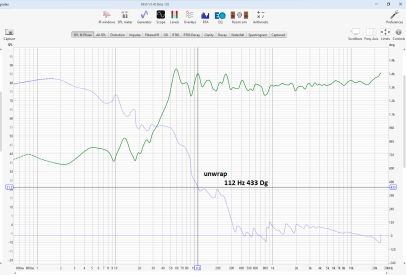

John, hi. I noticed strange behavior of the phase trace. If the phase line does not cross +180 -180 degrees, it is always displayed correctly. If the phase line crosses +180 -180 degrees, unwrap the phase and place a marker with the mouse pointer on the part that is above 180 degrees, then wrap the phase and immediately unwrap, then the phase graph jumps from 450 degrees, where the marker was before wrap, to -360 degrees, and becomes 90 degrees on the marker. That is, the same point on the phase graph not only shifts, but changes its value.
Some images might make that clearer, but it sounds like it is behaving as expected. 450 degrees and 90 degrees are the same phase and unwrapping ensures the value at the cursor lies within -180 .. 180.

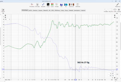

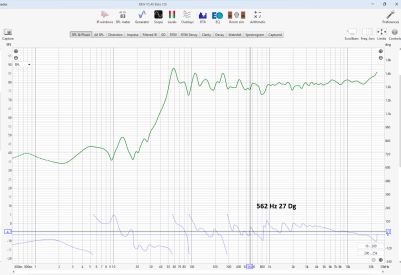

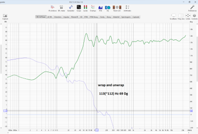

Images 1 and 2 are ok. In the 3rd picture, the 112 Hz phase graph point has a phase of 433 degrees. After wrap and unwrap, the 112 Hz phase plot point has a phase of 69 degrees. The same graph point should not have different values within the same graph. I understand that 69 + 360 is approximately 433. But if the unwrapped phase graph is shifted for better display at the selected frequency, then the axis of the phase graph must be shifted so that the same frequency has the same value in all displays.

Phase unwrapping is relative, it has to start somewhere. The reference is the wrapped phase value at the cursor frequency. That's how it has always worked in REW. The graphs are correct.
Everything is so, but. When the phase graph is formed, for the purpose of discussing the behavior of the phase, we can assume that all the values of the expanded phase on this graph are absolute. Otherwise, I will say that I see 433 degrees at a frequency of 112 hertz, and my opponent will say that this is not so, he sees 69 degrees. I will say that he needs to find the cause of the phase shift, and he will say that there is no such thing, there is no need to look for anything.
Perhaps if you add a checkbox 'link the axis of the unfolded phase to the graph', there will be no such misunderstandings.
