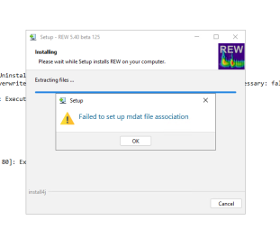

Hello new here, thanks for all the effort in developing this tool. :) and apologies if this is in the wrong section, you have a few different BETA threads open.
PC: Lenovo T460
DAC : Parasound Halo Integrated HINT
Mic: Umik-1
USB Driver: Via Audio USB Technollogy ASIO drivers with Kernel Streaming implementation
My use case is that due to the DAC and driver being very old , only the 32 bit version of REW will recognise the ASIO driver and send bit perfect to the DAC successfully via KS.
REW x64 Java Exclusive fails with this DAC, outputting a chirp that cuts in and out and the legacy ASIO implementation does not show as a selectable option in the ASIO selection drop down.
This results in requiring a 32bit instance to send the bit perfect sweep, and a 64bit instance to receive the java exclusive mic input.
The beta installer is failing for me but if you have a solution for my specific DAC\setup I would be very greatful, noting ASIO4ALL and FlexASIO do not like talking to this DAC. It's very picky about receieving low level KS data.

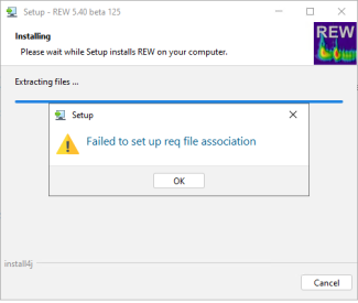

I get an"mdat file association" and "failed to set up req file association" error when installing the 32 bit beta in Win 10 pro 64. I can install the latest official 32 bit installer without any issues. I can also install the 64 bit beta without any issues.
After the errorsit then continues to complete the install seemingly successfully, however it fails to extract the REW executable file, so it can't be run.
install logs below and screenshots attached, do let me know if you need any other details. thanks in advance :
I suspect anti-virus or similar is sandboxing the installer so whilst it thinks it is installing the files nothing is happening, perhaps because the beta 125 installer is signed with a new certificate which SmartScreen doesn't trust yet. You can test that by trying the previous installer signed with the old certificate, https://www.roomeqwizard.com/installers/REW_windows-x32_5_40_beta_124-api.exe
Thanka for the suggestion John.
No luck unfortunately, so I tested another laptop and different OS same outcomes.
Summary of testing :
Lenovo T460
- Win 10 pro x64 fresh install latest sp and updates
- no AV or third party apps installed
- all windows defender and smart screen disabled
- latest beta and one version older you suggested both fail with identical logs and errors as previously advised
- both official release 32 and 64 work fine
Lenovo T420
T460
- Win 7.1 pro x64 fresh install latest sp and updates
- all other details the same as the T460
- test outcomes are identical
The 32-bit installation works normally on my Win11 machine, so I have no idea what would be preventing files from being written in your tests, sorry.
I shared the log with the installer provider, their comments are below. You have already covered most of their suggestions, but the temp folder suggestion might help. What stands out is the launcher executable (roomeqwizard.exe) doesn't appear in the list of installed files - it would usually appear after spark-swagger.conf and before roomeqwizard.vmoptions. That suggest the file may have been intercepted during the initial extraction to a temporary folder.
The installer ran with admin privileges, the elevated helper started successfully, and the Install files action then extracted everything to C:\Program Files (x86)\REW\ without any error.
The first and only failure is right at the end:
[ERROR] com.install4j.runtime.beans.actions.desktop.CreateFileAssociationAction [ID 80]: executable does not exist: C:\Program Files (x86)\REW\roomeqwizard.exe
What is striking is that the launcher executable roomeqwizard.exe does not appear anywhere in the install-file list of the log — there is no Install file: ...roomeqwizard.exe entry at all, even though every other executable and DLL in the project is logged as it is written. Every file installation in install4j fires a BEFORE_INSTALL_FILE event that is written to this log, so the absence of an entry means that on this machine the file never made it to disk in a state that the next action could see.
What this points to
Given that the same installer works for you on Windows 11 and for hundreds of other users, and only fails on this one user's Windows 10 and Windows 7 systems with both the old and the new certificate, this is almost certainly something on the user's machine intercepting the launcher file. The most common cause is anti-malware / endpoint-protection software silently quarantining or blocking the launcher executable as it is being written:
  • Some AV products delete the file between the write and the subsequent file-existence check.
  • Others hook the file API and make the write appear to succeed while no file actually lands on disk.
  • SmartScreen itself does not normally delete files, but third-party suites that "trust" SmartScreen reputation can be very aggressive with newly-signed executables.
What to ask the user to try
  1. Open Windows Security → Virus & threat protection → Protection history (and the history/quarantine of any third-party AV) and look for any item related to roomeqwizard.exe, REW_windows-x32_...exe or the temp directory C:\Users\sam\AppData\Local\install4j\.
  2. Temporarily disable real-time protection (and any third-party AV) and run the installer again.
  3. If that helps, add C:\Program Files (x86)\REW and the downloaded installer to the AV exclusion list and re-install.
  4. As a workaround you can run the installer with a different temporary directory, e.g. REW_windows-x32_5_40_beta_125-api.exe -temp C:\temp\rew. This sometimes helps when AV is interfering with the default temp location.
  5. After a failed install, ask the user to list the contents of C:\Program Files (x86)\REW — if everything except roomeqwizard.exe is there, that confirms the launcher was singled out by something on the system.
Based on the log itself, install4j is doing what it should: it cannot create the file association because the target executable has been removed from disk before the association step runs.
I actually used the temp folder as a work around previously to access the install so the exe is definitely in the temp folder. Strange that its getting intercepted on my systems even though both are clean, I must be doing something that I'm not realising as I'm the only variable in this chain.
I'll play around and troubleshoot, you've given me something to work with for now. Thanks John.
I'll report back if I manage to fix it.
If you have not already done this, try right-clicking on the REW installer and select 'Run as administrator...' from the pop-up menu. Under Windows 7 and Windows 10, there is a distinct difference between the local 'Administrator' account and local accounts that are members of the 'Administrators' security group. Old article (2012) referencing Win 7 and UAC (MSDN).
Ok I found the culprit . It fails because I select the "allow multiple instances of REW" option during install. When I uncheck that box the beta installs without any errors and runs fine.
