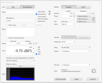

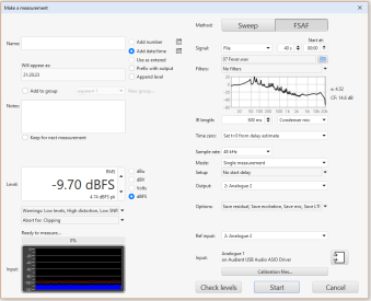

This only happens the first time after running REW. All subsequent openings of the slowdown window are not present. Should I take screenshots of the settings of the three tabs?
Settings for three tabs.
How long is the FSAF file? Does the Measure dialog open in FSAF mode when you get the delay or is it in SPL mode? Is there a Busy indicator shown during the delay?
FSAF file length is 35 MB. The delay appears with all three tabs with which REW was closed. But on the SPL and Impedance tab there is no delay indicator; a small window appears and disappears very quickly, the text of which is not visible. There is a delay indicator on the FSAF tab; it starts to 'spin', freezes almost immediately, and remains like that until the end of the 'Measurement' tab freezing.
