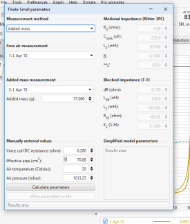

Thanks. You need to measure to a much higher frequency so that the impedance minimum after the peak can be located and the blocked impedance fit can be carried out. Measure to at least 2 kHz, preferably higher for a more accurate blocked impedance fit.
Edit: It would also be better to start the measurements at 10 Hz.
