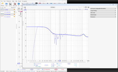

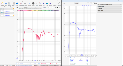

Any chance you could adjust the functionality of the EQ window? Right now, if I put the EQ window to the side of REW so I can see both windows, its nices to work using this layout for EQ. However, once I click on another response to EQ, the EQ window gets forced into a new position. I want the EQ window to remember position even when a new EQ is loaded.
Is this possible? It would be a nice quality of life improvement for me. Thanks.
I guess you are using snap layouts. If you double-click a measurement to select it rather than using the EQ right click action that won't happen. I'll fix the behaviour of the EQ action in the next build.
