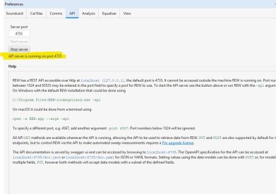

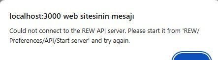

The rew API server is running but inaccessible. This happened after installing Windows 11. Could this be related? I'm asking for help.
It's always been like this and it's been working fine. I don't think there's a problem with it. Can you tell me what to do?
I have no idea what code you are running that wants to talk to the API server, who wrote it, or what it is expecting. Ask the author of that code.
