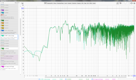

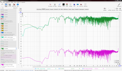

Yes, when the mouse pointer is over an entry in the legend, the measurement is highlighted. But I want the highlighting to always work after I"ve made the measurement the current double-click. Even if REW has screenshot hot buttons, it is more convenient to use the mouse. I also almost always use OS scissors.
I'll look at it. In the meantime you can use Ctrl+H to toggle the highlight for the selected measurement.
It works. Each time you press Ctrl+H, it highlights the selected measurement and turns it off. It would be possible to make the first double click turn on the backlight, the second double click turn it off.
