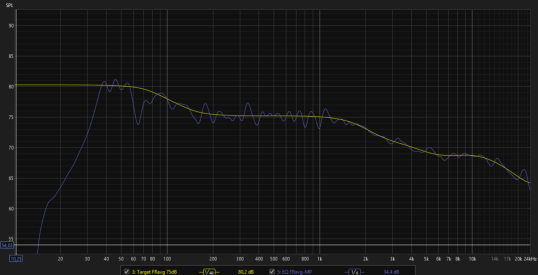

may be it will be better with an example:
this is a curve equalized to a given house curve:
the spectrogram is like this:
all good :)
this representation only show when is above 75dB, but the house curve is not 75dB flat. this makes difficult to do verification.

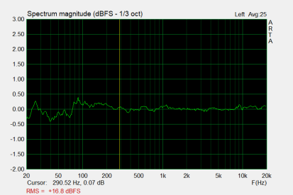

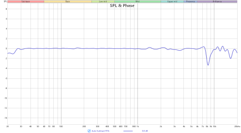

Recently I find a small bug here that when i load a measurement file (calibration-like) into RTA measurement,the super high frequency lower down about 4dB,not a straight line when you re-measure.
Make sure the measurement file was measured without any calibration file,and the SPL will be 100dB,then the error will show up.
It seems that there's no total coincidence inside(not a straight line).In ARTA,nothing wrong.
But,if you load a real calibration file which the SPL would be 0dB or so,the calibrated process will be OK and no issues with it(a completely straight line shows up there).
It's very useful when you want to see the difference in real time comparing the two or more speakers.Pls have a check for this thanks!.
I'm not sure what problem your images are trying to show. Please attach the relevant files.

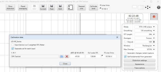

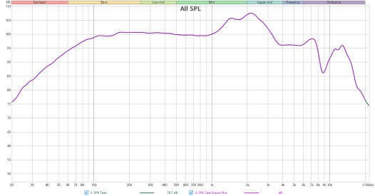

Hi,the file is attached here.That is to say,first measure a speaker's FR in RTA mode,then load the FR file as a calibration file and re-measure in RTA mode to see whether the measurement is a straight flat line,Unfortunately,there's a null in 8kHz and above.Pls have a check about this,thanks.
Works fine for me. Maybe the cal boost limit in the Analysis preferences is a factor for you.
Hi,John,indeed de-select the checkbox yeseterday.I did what you said but nothing happened,maybe I need change a soundcard myself,while my current card is Tascam US4x4.
Try taking a measurement using periodic noise and without averaging. The microphone should be in a fixed location, e.g. on a tripod.
