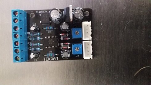

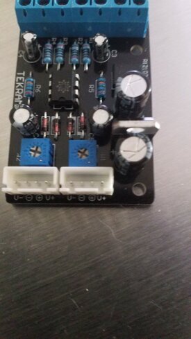

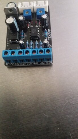

This is my current setup in Mexico
I am assuming the screw terminals are for the speakers and for power (for the VU Meter)... the there is a single cable that plugs into one of the white terminals in the 3rd picture, no idea where the other end goes
