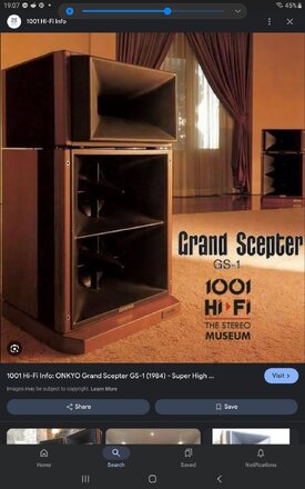

Coming Friday...my new horn setup. I chose this new setup because I have always like the look of the Onkyo, but my version will be a teenie bit larger and be possibly completely OB, or half OB and half with a cabinet. Size is about the size of a Jubilee with similarities to the Onkyo.
Wow... those look awesome.
I agree… those look amazing!!
Both horns are assembled to the frame and have the bottom woofers installed. Tomorrow I will get the top compression driver and woofers Installed. I hope I have enough wire for the bottom woofers. I know I have another XLR cable.
Beautimous!
You've been busy... and you got it looking really nice... beautiful work indeed. :T
My wife came home today and I asked her what she thought and she was not really pleased due to the size. I told her the footprint is exactly the same as when the f20 horn was laying down and the same height as when the f20 is standing up. Then she took a closer look and really likes the way the horns look now vs the ratty old black horns. :)
