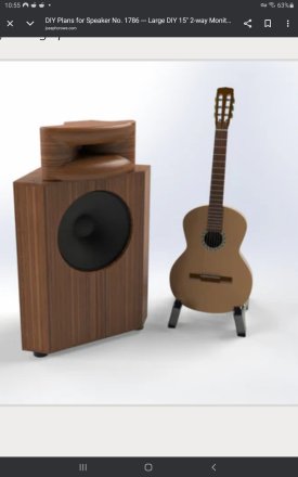

Today I sent the plans for the new surround cabinets to my carpenter. I am using Joseph Crowe plans, with my celestion ftr15-3070c woofer, jbl 2380a horn, and celestion axi2050 comp driver. We are using version 2 which is for the horn on top, and also front mounting the woofer instead of rear mounting. Cabinet will be BB ply, primered to conceal all wood grain, and then painted to match my k402 horns. The Jbl 2380a horns will be factory black with Mesquite or aluminum support. Custom 2 foot tall stands will be made to get to the correct height for the surrounds.
