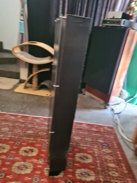

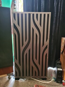

update: Today I completed my first Acoustic absorption/diffuser panel. The color is the charcoal metallic automotive paint we used on the rack support metal. I attached the panels with mirror standoffs, which pace it about 1" from the absorption panel. My F20 subs have been built for the test fit and the 1/2" wood finish is being made now. It is not the same wood as we were previously using, much harder wood, but will match nicely (I think). The new wood is twice as expensive, but 1/6th the price of the USA..I am hoping this weekend or sometime next week, I will have them both here. I might just put them where my front channels are and then put my MEHs on top of them on their sides since the F30s are almost the same dimension in one direction as the k402 horns are.
Those look awesome!!!
Some very nice bass bins for your horns... Because some is good, more is better and too much is just right... Can your horns actually sit atop the bins? o_O

For the time being...I am thinking of laying them both on their sides and put my tv on top of them, but I could also angle them in the corners to where the 3' side pointed toward me and then I could put the current MEHs like the k402s are on the Jubilees. Now when the mini MEHs are made...I can put them on top with the 2' side facing me and in both scenarios I would angle the horns downward toward the mlp. I am planning on trying the MEHs and Mini MEHs without a cabinet to see how I like them. When I first got the MEHs done...I tried them cabinetless, but I wanted a bit more bass...now I will have enough bass from the subs and I think the cabinetless bass from the MEHs might work out nicely.
