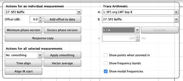

I've used REW, but I've installed a few new releases without using them. I'm now at version version 5.20 Beta 24, i use it on MacOS 10.14.6. I've used it today to update some documentation of a DIY speaker project. And I have found some issues with it.
If I used the Generate 1/A or 1/B it works the first and perhaps second time, but soon the Generate button stays greyed out and nothing is generated.

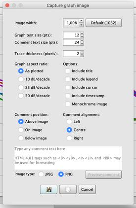

When using the capture button after using REW for .while, only first dialog pops up. After pressing the save button with the floppy logo, no dialog pops up to select the directory and file name. Thus essentially the capture can not be saved. Only when starting up REW freshly and make directly the capture first, then the second dialog pops up and the capture can be save. For the next capture you have to quit REW, start it up again and do the next capture, which is very annoying.
I uninstalled REW and reinstalled it freshly, but have the same problem.
Further I noticed, that at some moment the save all did not function. After pressing the button in the toolbar, the dialog for selecting the file name and directory does not pop up. It looks similar to the capture problem
I know that the 1/A function is rather new, but the version before that I've used without issues. So I no not know when the issues has creeped in, but it is rather recent.
The content of the log file for the generate issue was:

For the 1/A problem I'm guessing the trace you were inverting only had magnitude data, I've fixed that for the next build.
There must be some trigger other than time for the file dialog failing to appear, I've generated and saved measurements and captures many dozens of times and not been able to reproduce that. If you have any idea of something you were doing or that was happening before the dialog stopped appearing I'd be pleased to hear it.
I've restarted my mac and will try again. If there is a reproduction scenaria, I will make a screen recording.
Thanks. If it happens again can also try unchecking the box to use the macOS file dialog in the View preferences, maybe the Java file dialog will still work.
After a restart of my laptop, I did not have seen any issue with a missing file dialog. So some strange interaction of macOS with java I guess.
