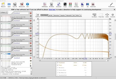

I am unable to get an input signal if my sample rate is set to 48, when calibrating my soundcard. I do when it is set to 44.1.
My interface and all other audio setups are set to 48. Not sure what to do.
Well I finally got an input signal at 48k but the measuring results may not look to good. Not sure how to correct this.
The oscillation you were seeing was due to monitoring being active, so some of the input was getting back to the output. Monitoring needs to be off for measuring, nothing the mic picks up can get back to the output.
During the "Soundcard Calibration" process, I need to adjust my monitor input level to get the input signal level near -12dB. In doing so, I seem to be creating a feedback loop. I have monitoring engaged and am feeding back into the inputs and I am not sure what to do to correct this and still get the right level.
When I set the interface software mixer to mono, it seems to resolve the issue but I have a feeling this is still not correct.
