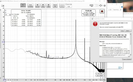

Sorry that my first post here is a moan, but beta 27 seems to have broken the RTA analyser. I've been using it to measure distortion on offline measurements taken from my LG G7 phone, recording the headphone output through my onboard audio and then dropping the wav file onto the RTA window. In beta 26 this would work intermittently, sometimes producing a java error, and sometimes just freezing at the end of the file load, but it would still identify the peaks correctly and show a proper result in the distortion window.
In beta 27 though this doesn't work at all. It doesn't identify the peaks and shows a nonsense result. I've attached a screenshot of the screen I get.
Here's the full java error text:

I hope this is useful
Thanks, I've fixed that for the next build.
