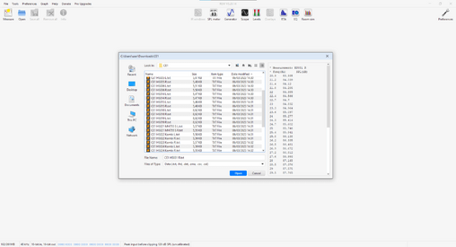

Also really nice would be the ability to load multiple measurements in the CTRL+O and CTRL+I dialogues:
CTRL+A to select all
CTRL+left click to select multiple
Shift+left click to select all in between
The measurement file dialog already allows multiple selection. You need to click on the files display to use selection shortcuts.
I'll allow multiple selection in the frequency response and impulse import file dialogs, but you can also drag and drop multiple files onto the main window to load them.

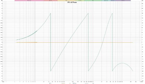

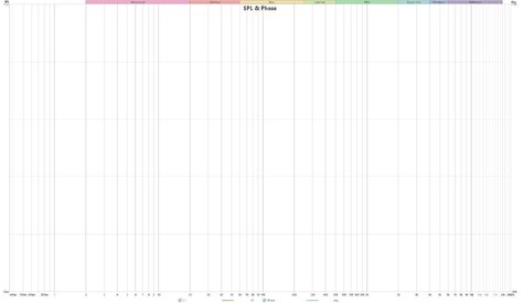

In SPL & Phase tab, "Fit to data" will lose impulse responses with a fixed 0dB SPL. The example below is a XO phase linearization pulse imported from rePhase but the behaviour is similar for a REW produced Dirac pulse.
What would be expected:
What "Fit to data" will do:
A very minor problem but makes it difficult to find and see the response again.
6,648
