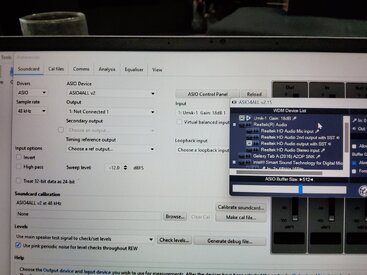

Hi, it's been a while since I tried REW. Yesterday I tried to measure my center speaker. I remembered I had to use ASIO4ALL. I tried that but in the ASIO control pannel i couldn't find any HDMI output (see the pic below), so i didn't get any output channels in the preferences window.

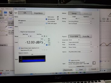

Anyway, for Java I found an output device (EXCL: Denon HD Audio Driver ...) that gives me outputs for all the channels. So I tried a measurement. Even I set C as the output, I got sound through the left tower instead of the center. Any idea why? I set C as output in preferences as well.

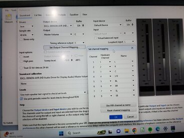

Are you using a V5.30 release? Use the Java driver and an EXCL device, show what the channel mapping is in REW preferences, and try a test tone to each channel and list what speaker you actually hear output from for each one.
I'm using v5.30.3 on a windows laptop.
I tried the pink periodic noise. When I choose L, BL, or SL I get sound only through the left tower. When I choose, R, SR, or BR I get sound only through the right tower. When I choose C or L+R I get sound through both towers. When I choose LFE I get no sound.
On all these cases I used Speaker Cal (500 to 2000 Hz).
Something is forcing stereo downmix. Are you using an HDMI port on the laptop, or some sort of adapter? Is the Denon reporting multichannel input, or stereo, while REW is active? Is the Denon in some sort of stereo output mode?
Yeah. The Denon app shows me PCM, stereo input. The ouput is actually multi channel.
I use an HDMI cable to connect the laptop to the AVR.
Check the Properties for that output device in the Windows Sound control panel, that "Allow applications to take exclusive control of this device" is enabled, and that all Enhancements are disabled. Are you connected to a rear HDMI port on the Denon, not a front port?
