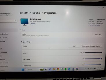

Is this the option you're talking? It looks like it's enabled. I don't see an option for enhancements.
It's interesting that even in this menu I have only 2 channels for testing.
That option is enabled. Apps are allowed to control the AVR. There is no option for enhancements. The laptop is connected to the back of the AVR.
I tried to play a movie of HBO max on my laptop. The sound passed to the AVR was stereo too. It looks like it might be an issue with my Acer laptop.

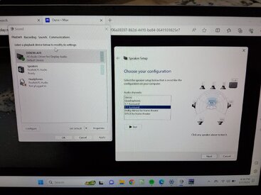

That does seem to imply only stereo is supported, either limited by the laptop driver or the port you're connected to on the AVR, but I meant go to the Sound control panel. In System>Sound (one menu level up from your screenshot), if you scroll down, under Advanced, there should be a "More sound settings" that should bring up the Sound control panel, or you can search for "Control Panel", bring that up, and then click on Sound. Then right-click on the Denon-AVR device and select Properties. Look for an Advanced tab, where there should be an Exclusive Mode section with "Allow applications to take exclusive control of this device", and an Enhancements tab. But probably more important now, look at the Supported Formats tab and see what it shows for Max Number of Channels.
OK, found it. There is a configuration window where I can choose the audio channels setup. When I test the center speaker I get sound only through it. However, when I go back to REW I still get stereo sound and no center channel sound.
I tried to play Dune on the laptop and I got 7.1 surround sound. So now, I'm not convinced is the laptop anymore.
BTW, the enhancements are set off too.

Can you generate a debug log file using -DcsjsoundLibLogLevel=debug as you've done in the past, and upload it?
I have to take something back. When I play the movie on the laptop, I actually get sound only through the towers and the sub. I got confused because the svs app was showing multi channel input. So maybe it's a decoder issue? When I tested the center channel in the configuration window I heard sound through the center channel.
Download
and play it using Windows Media Player, and see if you correctly hear output from each of the 7.1 speakers.
Edit: Make sure Windows is configured for 7.1, and check what input signal the Denon reports while playing the clip.
When I play the wav file I get sound through each speaker, one at a time. Denon was showing 7.1 input.
I'll try to get a log file, if not today then tomorrow.
I got ready to generate the debug log file and I tried the pink noise on the center channel. Guess what? Now I get sound through the center channel. Maybe something was stuck on stereo when I tried it before and it needed some iterations to get reset. As far as I can tell I didn't do anything different this time.
Anyway, it looks like it works now. Thanks for help.

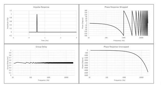

Dear Developer,
I have noticed that the phase unwrapping feature in your software is not functioning as I expected it to, nor is it behaving as described in textbooks. The user manual mentions that unwrapping should adjust the phase within the ±180° range based on the frequency location of the mouse cursor. This seems to introduce difficulties in interpretation and understanding. There are times when I would prefer it to accurately reflect the absolute phase difference based on a 0ms timescale. This would help users understand filters and distinguish between what is leading or lagging.
I wonder if I might be making some operational error, as I am unable to achieve this result within the software. I would greatly appreciate your assistance with this issue. I am a dedicated user of REW and truly enjoy its functionalities. I am keen to see it continually improve.
Attached are some images depicting common phase unwrapping scenarios. However, I seem unable to replicate these in REW.
Thank you very much for your support.
REW looks correct to me. The group delay plot in that image you attached is amusing, and nonsense.
