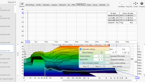

I tried all the measurements one by one. Now there is no mistake.

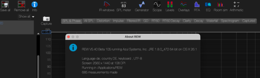

Hello dear REW developer John Malcahy, dear users!
Just a question ... here on iMac the typo / fonts in REW are really hard to read and thin, somehow unsharp too.
Is it the Mac version only or is my installation not ideal? :)
KR

Unfortunately, this doesn't change the appearance; I wonder if other Mac users have the same problem.
Update:
Did a completely new installation, nothing changed. If I rise the font size to 22 or bigger the typo is OKish, but huge even on the 27", and yes, it's the fine Retina screen.
There's no other app that looks this way. :)

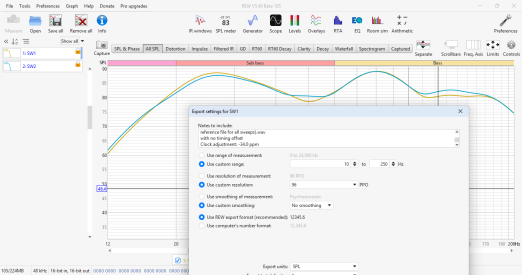

Just checking that this functionality is intended here. Typically, when I smooth a response to psychoacoustic and export it, it would be exported as text with that smoothing even if none was applied at the export level. When exporting as text now it exports with no smoothing even if smoothing has been applied on the measurement screen.
I'm just checking that this is normal, and that if you want any smoothing to be applied to your text export it can only be done on the export screen, right?

Retina Display Rendering Issue in REW on MacBook M1 Pro
Hi there,
I’ve been experiencing an issue with REW on my MacBook M1 Pro 16-inch, running macOS Tahoe 26.1. The problem is that REW doesn’t render properly on my Retina display — everything looks blurry, including fonts and lines.
At first, I thought it might be an issue with my operating system. So, I did the following:
  1. I installed a fresh version of macOS Tahoe 26.1.
  2. I reinstalled REW on this clean setup.
  3. Unfortunately, the problem is still there, and REW continues to display poorly.
I’ve attached a screenshot for reference.
I would appreciate any help or advice on how to fix this!
Thanks in advance!

Builds updated today (beta 106) with these changes:
  • Changed: Java runtime updated to Java 11
  • Changed: Installer uninstalls the previous version
  • Changed: "Scale fonts for display DPI" View preference has been removed, font scaling is now automatic
  • Changed: Add support for UMM-6 with a device name of UMM6
  • Changed: The menu.properties file has entries for SELECT_DESTINATION_TITLE and SELECT_DESTINATION_TEXT, used when trying to save a file without a destination
  • Fixed: Aligned sum notes showed additional delays if remove time delay was selected
  • Fixed: Aligned sum window settings were from the first measurement, which might not span the result
  • Fixed: Null pointer exception could occur in RT60 decay calculation if the measurement did not have valid T20 data at some frequencies
The big change is the Java runtime update to Java 11, made necessary by macOS Tahoe breaking display scaling for Java 8 applications. That required quite a lot of internal modification, particularly around icon handling. If you notice any odd appearance or behaviours please let me know here.
