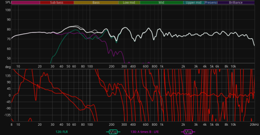

The color of the phase traces when using the Alignment Tool in Linux seems to be fixed to RED only. Works perfectly fine in Windows...
It's the same code on all platforms. The phase trace colour comes from the measurement colour, so that's pretty strange. What build is running on the Linux machine?
In my Windows, also only red. John, is there a way to change the colors of phase traces to the same colors as the frequency response?

It shouldn't make any difference. I'm trying to work out how it is possible for the phase traces to be red instead of the measurement colour. They always plot as the measurement colour for me.
The 'Save trace colors with measurement' option is checked. I opened a previously saved measurement, saved it under a different name. Closed the REW. Opened the saved measurement. But all the phase colors are still red.
I just updated to the latest beta 77 and the color is fixed to red in Windows 11 also now. Tested Linux on Mint debian edition and KDE neon -- same fixed red phase traces.
