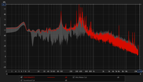

The problem of phase traces plotting in red occurs if the smoothing chosen on the Alignment tool dialog differs from the smoothing of the measurements.
That's right. Also, if the measurements were not smoothed, they remain unsmoothed when opened in the Alignment tool. But the colors of the phases are only red. After that, any change in smoothing in the Alignment tool or in the All SPL window does not change the red color.
Maybe this is also fixed, but it may be useful.

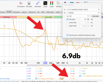

When using Trace Arithmetic, and Magnitude Division, is there a way to set absolutely boost limits? I've tried using Regularization, but it doesn't work in the way I'd like it to.
Here's what I'd like. Add an ability to check a boost limit or positive gain limit when using Magnitude Division. I only want to a positive boost of +6db, and never want to go over that.
When using Magnitude Division you can see boosts of around +8db in parts of my EQ that you have to manually pull out. Adding a boost limit would really be helpful.
Am I missing something with Magnitude Division, or can something this be added?
Thank you.
I tried using the +6db boost limit, and I still get boosts over +6db.
I tried using frequency limits, but they only apply to what is being EQ'd, and not what is being boosted.
If I could control this so the max gain would only use +6db boosts it would be perfect. But as it is, I don't see how the main gain setting works.

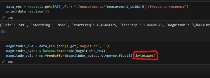

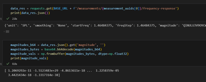

I'm trying to pull FFT magnitudes through the API, but decoding the base 64 string and converting the bytes to a 32-bit float is yielding some wild numbers. I'm simply taking the encoded string, decoding as base 64, then taking the bytes and converting to float32 with numpy.
If anyone can take a look at my trace and accompanying code here, I'd appreciate the help. There must be some part of the implementation I'm missing.
Thank you!
Thank you!
Nevermind!
After using numpy to convert to 32-bit floats, I had to add .byteswap(). I don't know enough to explain this; it was a copilot suggestion.

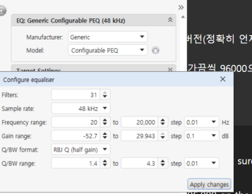

Hello John, this has actually been happening since a previous beta version (I’m not sure exactly when) – is it just me experiencing this?
My REW setting is 48,000 Hz. However, sometimes it keeps switching to 96,000 on the EQ tab.
Below are screenshots of the settings.
So to avoid this, force-set the sample rate once in the PEQ settings.
This outputs a single filter at 48,000 Hz, and then the Generic EQ sample rate also reverts to 48,000 Hz.
Of course, that workaround works, but I’m not sure why it’s changing like this.
