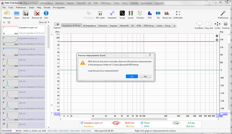

Should the 'restore last deleted' measurements button restore the one measurement that was just deleted? And if I deleted 8 measurements, this function does not work? I removed 1 measurement - it works. I deleted 8 measurements - it is not active. This happened several times. And after the restart, REW reported that it could not complete normally and there were 138 measurements to restore. I took impedance measurements.

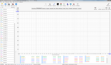

Second question. There is confusion with measurement numbers. I'm removing one measurement from the Impedance & Phase tab. Then I go to the ALL Impedance tab. There are 35 left in the legend, and 34 on the left.
The third question, I'm not sure about this one. I assumed that I was deleting one group of measurements, but another one was deleted. The measurements are not arranged in groups, just one part and another part of the general list.
Actually both have 34 measurements, but the numbering shown in the legend is wrong for measurements after the one that was removed. I have fixed it for the next build.
