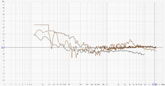

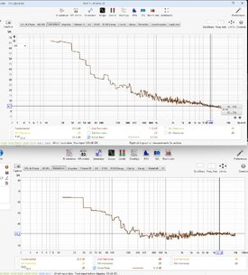

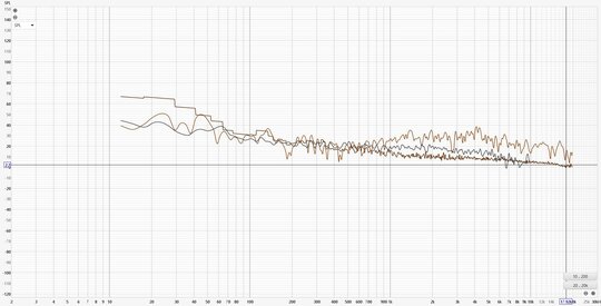

Does the latest Beta have a known issue with the noisefloor reading incorrectly (or something related to that).
See my screenshots of just a quite room measurement...I'm comparing the results of 5.31.3 to Beta 58 (everything set up the same) and I'm getting wildly wrong readings with Beta 58 for the noisefloor, which has me concerned that I cannot trust the measurements (which do look about the same between versions).

See changelog posted above..
V5.40 beta 45 27th July 2024
  • Changed: Use frequency-dependent windows to reduce the noise floor of sweep distortion measurements
