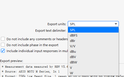

4 more suggestions for you to add in REW:
1.Would you think of adding an unit of exportation of group delay,which can be imported in other simulation tools?
2.Measure the SPL and Imp,adding a sweep signal range from 20kHz~20Hz(from high to low) might increase stability of the test result just like soundcheck.To some extent it may reduce the 'hush' sound annoying during the test.
3.A brown theme like sunset should be considered to put into TO-DO-LIST.
4.Volume or adding mass method should show the optimal fs shift percentage(20%~50%) after 2 curves overlay,which can get rid of the manual calculation.
Thanks for your reply.​
That wouldn't be a unit, it would need a separate export for the group delay graph. I'll add it to the todo list.

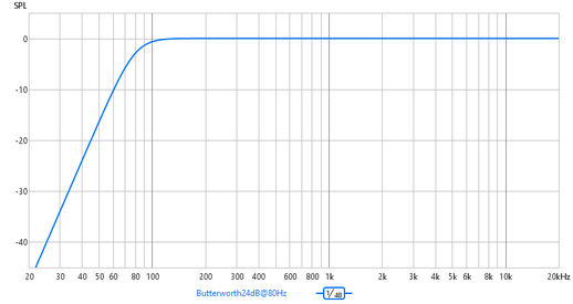

Hi John,
I might doing this incorrectly but when I create a electrical filter in the EQ screen and generate measurement from it, the generated measurement does not have the phase component. See below.
I was hoping that the generated measurement would have a phase component like this one.
Below is the speaker measurement before and after applying the filter (used the arithmetic A*B function).
The phase response of the speaker is not modified "as it should under normal circumstances" when such a filter is applied.
I was expecting something similar to below with the red graph showing the original phase response and the green one representing the phase repsone with the filtter applied. Am I following the correct method in using electrical filters or is the design intent to produce filters without phase response from within EQ screen? It would be great if the EQ screen can have an option to include phase in the generated response.
Did you use Generate measurement from filters, which will produce an impulse response from the current filter settings, or Generate measurement from target shape, which only produces a magnitude response?
Hmm, just realised that when I use the "generate minimum phase" option for the electric filter under the SPL & Phase and use the same arithmetic function, I get the correct phase response. It would still be prefereable in EQ tab, to generate filters with phase response to avoid the extra step.
No, I just used the Target Settings to simulate a filter I want to apply to the speaker response, not necessarily to equalise the speaker's response or generate measurement from filters which in this use case, would be flat. It is the generate measurement from target shape that I used but as you said, it only produces a magnitude response.
See above, use Generate measurement from filters.
Using that option produces a flat line. I am trying to use EQ more as a crossover simulator "without equalising/matching the speaker response against the target curve using PK filters for an example" to better understand its behavior.
