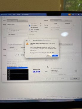

I'm attaching some images so you can see a bit of what's going on.
Would appreciate any guidance on getting REW setup correctly to work with the UMIK-1 mic and REW on my MacBook Pro.

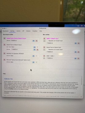

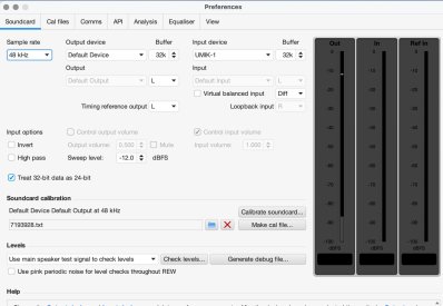

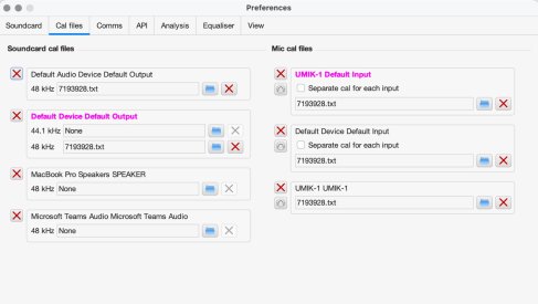

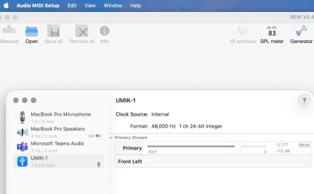

OOPS, my bad.....sorry, not thinking clearly, been a bad week.....
Here's a few screenshots, one of Audio MIDI Setup and others of REW.
Thanks!

What version of REW are you using? Are you getting the latest beta release found here?
It looks like the mic calibration file is also being used as a sound card calibration file. Not sure if that will cause the low input level message but it would certainly cause a measurement to be wrong had there been one.
Yeah apart from what @JStewart said, I don't see any issue with the way you set up your preferences. At this stage, all I can suggest is that you try another computer (excludes a problem with your hardware and any software conflicts) or try another UMIK-1.
Also make sure that there are no other programs open that have exclusive access to your mic.
I'm using the latest beta version, thanks.
Oops, wasn't thinking clearly, when doing that setup...thanks!

And REW does not recognize the timing reference or???
It seems to recognize it but it is very faint and get the error message about low signal.
Maybe you need to turn the volume up at the Yamaha receiver? You will probably want 70db to 75db...
I tried that....even much higher volume but made no difference.

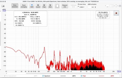

EDIT / UPDATE
I tried connecting UMIK-1 again and checking settings and adjusted volume again. Then tried speaking into Mic and checking response in REW in Levels and RTA.
Got response!
Please see attached screenshot.

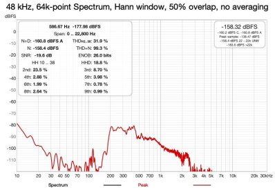

Please see the attached graph made with UMIK-1 placed about 6" from the left JBL speaker.
Let me know if this looks like it read the sound correctly.
Also, if it did, let me know what the graph suggests to you about the speaker.
Thanks!

Thanks, you don't think it's possible it has to do with the levels not being set correctly?
Let's look at where the points of failure are:
- UMIK-1: NOT excluded
- USB cable: Excluded. You have swapped your USB cable.
- USB port: NOT excluded, although it seems unlikely if other USB devices work when plugged in.
- MacOS software setting or conflict: NOT excluded. You could run Windows VM to exclude this.
- REW setting: Probably excluded. As a sanity check, you could download alternative recording software, e.g. Audacity, and see if you can record your own voice.
We are talking hundreds of dollars for a new mic here, it is important to make sure your current mic is faulty before spending any money. The simplest and surest way is to borrow a UMIK-1/2 from someone else and see if it works. You are in Silicon Valley for goodness sake, there are millions of nerds there and they are all rich. Surely someone has a UMIK-1, you just need to find them. Maybe someone on AV NIRVANA lives close to you? Anyone want to help this guy?
