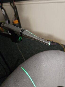

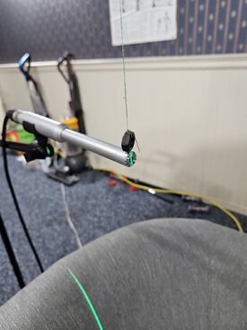

So.... I ended up buying the M23 microphone. Using HQplayer, I was able to save both convolution files from each microphone, and compare them on the fly, and switching back and forth instantaneously.
Could I hear a difference... YES.
Does the convolution file from the M23 sound better.... YES.
Is it enough difference to justify the cost...... Probably not, but I didn't want to go back to the Sonarworks. I've heard bigger improvements from cables. I bought it at a retail store that allowed me 30 days and I could return it. But decided to keep it.... Cause of the small improvement and I suppose, peace of mind that I'm using very high quality microphone.
It's mainly improvement in imaging, and possibly better tonality, but that one could be in my head, it's that small.
I took a short video of the measurements being compared back and forth.

If you are referring to the delay time after each measurement.... Extremely consistent. Either of the microphones are extremely consistent. Every time I do measurements I take at least 6, so that I can compare and root out the ones with strange anomalies. Never changes.
0.0 delay.
I have a really good way and system set up to make sure the mic is in the exact same spot every time. Infact, I've taken probably over 80 measurements in the past 6 months....and I always get 0.0 delay.
0.0 delay.
