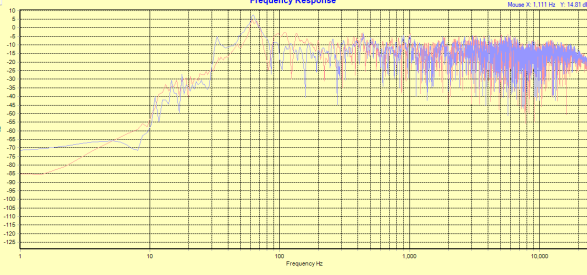

So you think the LF bump is from the sub? can the sub be measured separately? If you have a 2.1 system it should be measured as 2.1. That way AL could also time align your sub, which can boost sound quality significantly. A decent tripod is a must.
Here is a measurement with the sub off .You can see the difference right? I currently have version 2.0, for a 2.1 measurement can I use version 2.0? Will look on the tripod. I used a cushion on the sofa in the past :(. My DAC is only supporting 2 channels, for 2.1 I will need a DAC that supports 3 channels?

Hi, This measurement makes much more sense. The difference here is the room. I am not sure about your question with the AL version. At any rate if it doesn't then upgrade. That is if you can measure the sub as a separate channel. It isn't clear to me how the sub is crossed and from where. DAC/Amp?

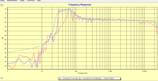

Hi, Newbie here that also got lots of help from a friend, but still on learning path. Using version 2.0 Wanted to ask if the outcome of my measure are acceptable or what can I do to improve. I just read that increasing the memory to 160% and reducing time to 7 sec from 10 sec. Please see belowView attachment 81726
View attachment 81722View attachment 81723
The measurement looks fine from here.
I recommend that you experiment with different target shapes in the bottom. What you have here may be perfect for you, but perhaps you should try something that doesn’t have the sharp bass peak as you are getting now. A bass that doesn’t rise, but starts to round off sooner sometimes sounds faster and deeper … and sometimes the whole speaker sounds faster and deeper. This is a matter of preference, and now you have the tools to find out yours…
Many thanks! This means have a flatter and wider mountain 🏔️ instead right? Then the rest of the curve follows as previous correction curve?

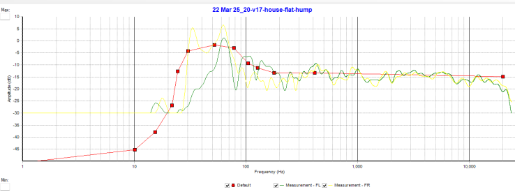

Testing Bernt suggestion!

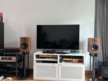

Hi! Got new speakers, Kudos C10, adjusted location of subwoofer, measurements where much balanced

For my preference, my setting just needs minor adjustment on a bit boomy base that comes on certain low frequencies. So I tested a very simple target
Here is what It looks like.
Got to say, this is the best outcome I got! just touching the low frequency area more, the boomy effect is gone, even at loud volume. The rest sounds more balanced without affecting much original sound. I'm updating to XO version and see if any more improvement can be achieved.

Enjoy the new speakers. The measurements that you posted are without the sub I assume.
Many thanks!! No, its with the Sub on! Amazing is much balanced . I will need your support with my XO process _/\_

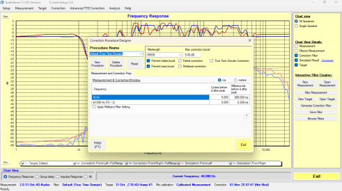

Sorry, I'm a bit overwhelmed with all the features of XO, I have not much idea what I'm doing now, just did the measurements ( I use a focusrite scarlet 3rd as was suggested). Using version 2.0 was quite straight forward. XO has so much going on, any support will be appreciated.
Here is what I've done so far and generated my correction filters fo HQplayer.
For filtering measurement I selected the default option
Then I made the target design
Generated correction filters
Reading manual and trying to get an idea of the special features.
I tested the max filter lenght and compared to ver 2.0, the version XO sound is more bright and lively, and yet haven't use its full potential. (here first filters without TTD feature)

Made and export similar to @Bobski321 , I changed it to 2dB the bosst, and I get a more beefy base, but not overpowered. The speakers are more "Free" as before but more controled on the base (less bummy but stronger than before) (used the default TTD)
