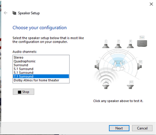

My AVR is connected to computer via HDMI and it sees 7.1 and I can hear test tones from each speaker when using windows sound settings.

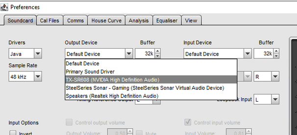

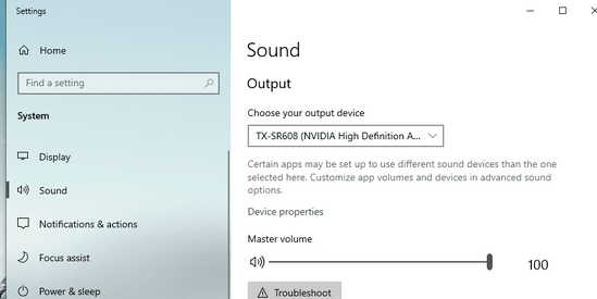

Yes, my receiver appears in the windows sound output list as well as REW but only in Java.

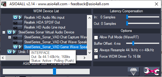

Is it not available for selection in ASIO4All? May want to try FlexASIO instead if it doesn't appear.

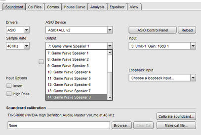

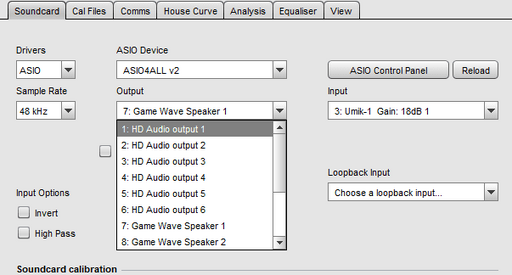

Fixed! I had to uninstall the released version of ASIO4ALL and download the Beta version that supports windows 10. After I did that it all came into play.
Hopefully this helps anyone else with this issue.
