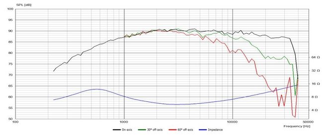

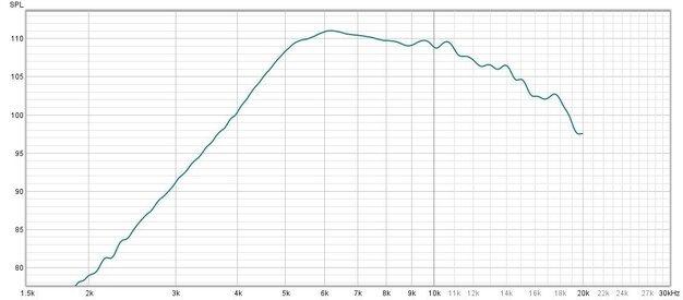

I find this an interesting discussion, as I was about to post a similar question. I'm doing some tweaks to my home-made speakers. A number of years ago I bought a pair of Scan Speak D2905/930000 tweeters, which were reputed to be pretty flat in their response well beyond 25K. When I installed them I found that my Behringer 8024 Ultracurve Pro couldn't perform an GEQ on those tweeters at 20K, at which point their output was dropping like a stone. I still have those tweeters and am now using REW to attempt PEQ on my system (no longer with the Behringer installed, I use a PC with JRiver MC31,and a Wadia di122 decoder as DAC and preamp). The output from the tweeter still falls like a stone, as can be seen below (this is a near field, on axis measurement, with only the tweeter connected. By 22K the ciurve is almost vertical). I'm using a UMIK usb microphone, with the proprietary calibration file (with my Behringer I used similar but different microphone from the same manufacturer). Initially I thought that maybe I had done something awful with my home-made crossovers (e.g., a bad impedance compensation or too much padding) but following the thread here, maybe all is well and what I'm also seeing is a measurement error and I don't have to get my soldering iron out!
I've included below the manufacturer's specs for the tweeter. I'm old enough that I can't hear well above 15K so I'm sure I'm not 'missing out' when it comes to the reproduction of my speakers, but I certainly want to know if I've made a mistake in installation of my tweeters. There is plenty of baffle surrounding the tweeter, at least 4" each side and above it.
