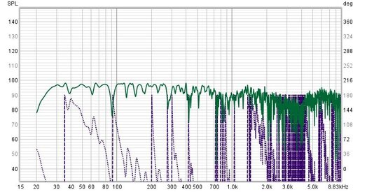

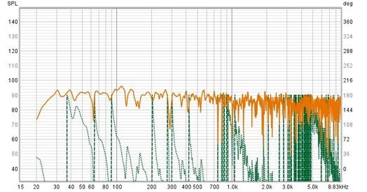

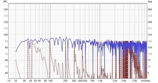

Two dips in L/R FR but not in Left and Right Individually
Trdat
Nov 6, 2019
191
I have a more pronounced dip at the crossover point of 950hz in the measurement with Left and Right together than in the individual measurements and there is another dip further along at 3500hz.
These measurements are with REW using a correction filter that looked good enough in Audiolense.
Any ideas? Is the dip at the crossover pont normal? How can I work it to ensure a flatter response?

These are almost guaranteed to be due to phase differences after correction. Mainly you should improve your acoustic environment to get a flatter sum, but what you see here is 3% of what you should expect to see from a system that doesn't do FIR correction ... typically it sounds balanced, but the sound stage is very unfocused compared to using a set of very good FIR filters. So how does the sound stage appear in your place? My guess is that it sounds like the walls have disappeared ... compared to not using the Audiolense filters.

Well, the above measurements are on my XO system so I don't have the option to toggle on or off Audiolense but overall it sounds fantastic I was just curious if that was normal and if we could do anything about it?
My room is heavily treated. Plus, it was weird for the L and R to be very flat and the L/R to be not as flat.
So you are saying its perfectly normal to get phase issues that might effect the frequency repsonse?

Yes. Also, try applying psychoacoustic smoothing and check the results. Almost certainly inaudible. You might end up pulling down some of the HF bumps to get a proper downslope. Otherwise your curves look outstanding.

Great news, yes I got a decent step response to.
Pshycoacoustic smoothing in Audoilense? Where do I find it?
