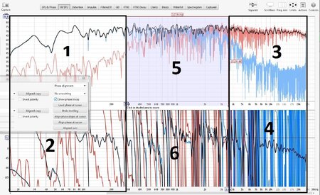

John, is it possible to make this change in the Alignment Tool? Area 5 in the picture is highlighted with turbidity. When working with sliders, you can highlight areas 1, 2, 3, 4 with this blurring. And leave areas 5, 6 normally visible. In area 5, when selecting delays, something changes in the black graph, in the resulting graph, because the levels of the original graphs range from 0 to -30 (approximately) dB from the main one. When added, they have a noticeable effect on the result. In areas 1 and 3, nothing changes because the levels of the lower graphs are too low. It is difficult to understand up to what frequency to pay attention to the addition of phase and amplitude graphs, and where it is not important. Perhaps you can come up with a way to highlight the graphs in areas 5 and 6 by highlighting. But it seems to me that highlighted with turbidity areas 1, 2, 3, 4 is better. You can also give the user the opportunity to specify at what difference in levels to draw the line between significant and insignificant areas.
