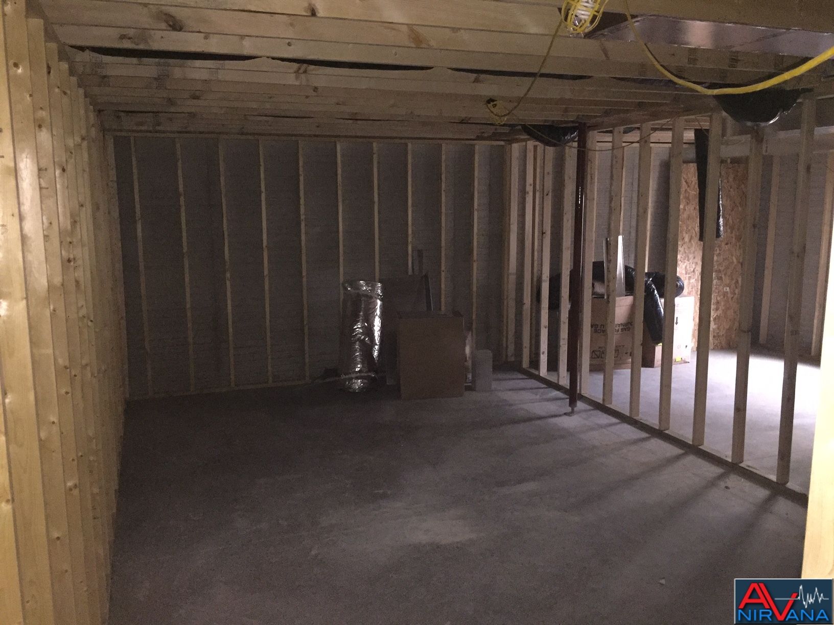

The other question was related to heat from the electronics. I plan to mount the electonics flush in the rear wall where there will be a space under a stairway adjacent to the back wall. My builder has said we could probably run an HVAC return duct above the back of the room, pulling heat away from the projector and front side of the gear rack. I plan to use some kind of temp triggered ventilation system for the cavity behind the gear/under the stairs. There will also be a small closet sharing that space so I plan to make it as easy as possibly to access the rear panels of the electronics after installation.
As long as you have air being pulled through the rack space you should be fine, Thats how I do it and Ive never had a heat issue. The return duct back to the A/C will pull cool room air though the rack and thats all you need. Just make sure the receiver/processor and amps have a space between them (not rack mounted directly on top of other equipment with no space).
