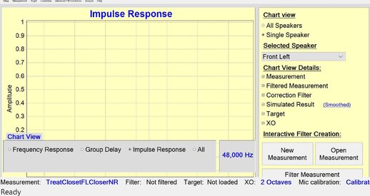

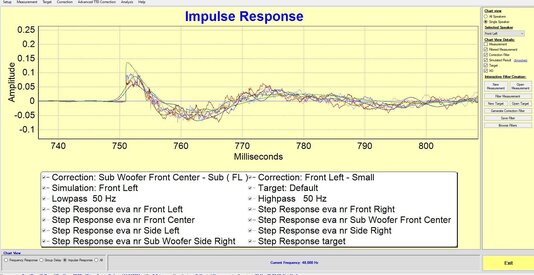

Hi Bernt.
The scaling now seems ok on my 4k TV screen, but I have new issue with scaling when I use remote desktop connection (I use RDC when working on filters from my main desktop machine).
The display where AL is installed is a 4k, but my RDC desktop is 1080 resolution.
When I open AL from within the RDC session, everything is blown up and some of the screen is pushed off the display. Anything you can think of to fix this?
I can't find any display settings for the RDC session that will improve the situation.
With previous version scaling worked nicely from within RDC session
A work-around that kind of works is as follows, but scaling is still a bit off....
If AL is opened on 4K machine prior to starting RDC session, then scaling is somewhat better on my main desktop, but still not correct. Hopefully you can see example of that from attached jpg.
Also, many of the dialogs are scaled incorrectly.
This was a scenario that I didn't see coming.
But if you x out two files the scaling will be 100% graphical, like it used to be.The two files at the bottom.

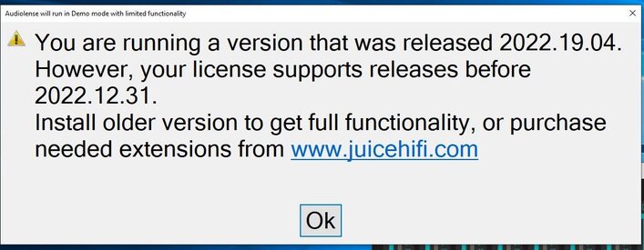

Seems 6.20 seems to have issue with the license check
Hi,
I have the same license issue as well.
51228
