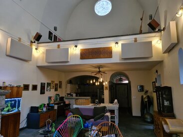

Finally a little progress...
5 6" thick acoustic panels (4" of Roxul) for the front (black burlap)
4 6" thick acoustic panels same as the front, but in natural burlap

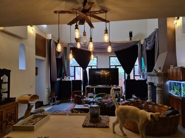

6" dimmable LED lights for the living room controlled via Insteon wall switches
1 new wine stave chandelier with 8 dimmable LEDs, and mone large LED. This is controlled via 2 Insteon wall switches.
Front is a mockup to see 8f we have enough material for the valance. The center will have another layer sewed tonit to allow it to come down lower. I have Peacock blue tiebacks that will be used for 2 purposes...one is for holding the valance to the framework, and the other is to tie back the curtains to some black steel brackets behind the tv on the wall.

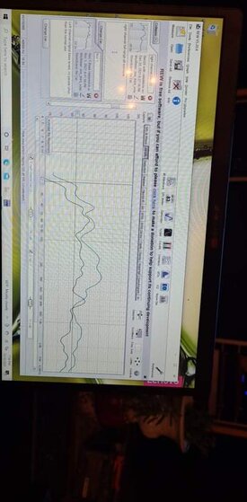

A little update... i have now completed the wiring of 1 125asx2 BTL module per woofer, and ran the first REW for my friend Chris to tune. The old REW was good, but the new readings look great!. First look wss about 15db higher at 20hz, and that was after lowering the bass gain by 8db. One thing it also did was mess up how flat it was before, and now it has a bug bump around 100Hz...as well as other discrepencies up to 1k. Now to be honest I have another thing I did for this tune besides the amp. The other thing was I refined my measurement technique. When we originally tuned them I just laid a 2x4 piece of Roxul in the gap between the horn and the cabinet on each side of the cabinet, put onempiece of Roxul on the floor, and 1 after my DIY Mic stand. This time I used my 6" deep acoustic panels and made sort of a box. I wanted to have it be a complete box, but my other panels are mounted up high on the walls. In the future I hope to have 1 or 2 more panels to complete the box better. I also used some stick on felt to to help stop the reflections. I would have used more, but I ran short. I was not perfectly square when I took the picture so it looks like it is not centered on the horn throat, but it is.
I reran REW today, and this is what it looks like after 8db gain cut on the bass. I have that huge peak at around 100hz still, and a big dip 700hz.
Does anyone know why this would happen when all I did was run a duplicate amp to each woofer instead of connecting both speakers to one mono amp? The bass is much better, and if I can retune it without messing up the phase growth it would be perfect IMO. I also do not know why REW is not going below 23hz, when it is set to go to 10hz. Just to be safe I have another mic on the way to see if it slipped out of calibration somehow in the last 6 years of use.

Woofers are now installed. This is a REW I ran with the old tune, and the new woofers.
1st pic is the old tune, and the 2nd is how I tuned it (I need someone to look at the 2nd one to see what is wrong with it.
