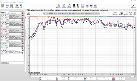

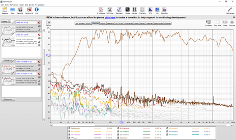

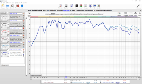

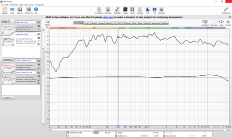

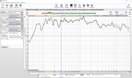

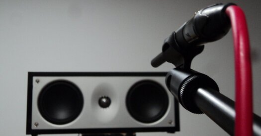

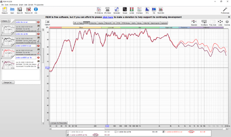

I found some measurements,comparison between dbx rta-m premium calibrated at CSL,behringer ecm 8000,calibrated at dr.jordan,sonarworks xref20r5,factory calibrated,i did not include usb microphones,jack,trrs.Hmmm,you made me interested in umik-2.The measurements are with and without calibration files.
Thanks for sharing those , I did the same thing with all my mics awhile back. And of course they are all pretty close to eachother.
And it made me think , and think , and think….. why do they sound so different??
I can plug in any of my mics and run Dirac 5 times or more , and get the same exact results….
I plug in another mic (leaving everything else the same) sounds different. Tonally different and different spatial staging….
So it started my quest for the perfect mic because I love the frequency responce of the cm-10 , but the staging of the umm6
The umik2 from cross spectrum does much more then I could ever expect. It made a huge improvement…..and again… it measures really close to my other mics…
There’s got to be something else going on besides frequencie response… although 1db here and 1db there adds up to hundreds (maybe thousands) of db variants…. But there still something else and I don’t know what it is…
This mic “self noise” thing…… I wonder if that has something to do with it..
The umik2 does not have the small capsule either, it has a metal plate with some wires on it and a little gold stick thingy…. Totally different!!! I’m fact i sorta laughed at the fact the umik1 has the slots on the tip for the diffuse field thingy (I think) when the capsule head in mounted directly on top flush. So those slots were just for looks, nothing was under it…. The umik2 clearly utilizes those because the plate is obviously under that. With umik1 It was like a basic cellphone capsule mounted on a mic to look like a professional mic. They could’ve mounted it in a plastic housing like the audio frog mic…. Boring.
Idk…. Umik2, It’s so much better and gets down to business :devil:

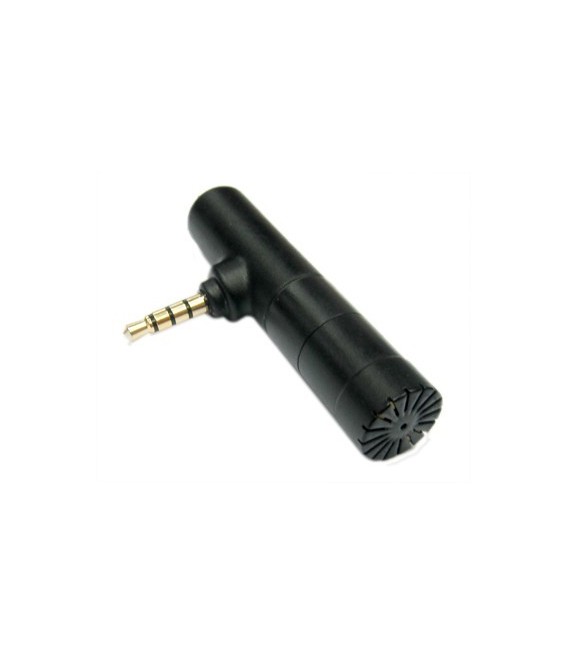

I have a little PMIK which I like a lot. It has the right diameter for use with Level Calibrators. I can hide it and an iPhone on me in Nightclubs when doing Noise Surveys etc. etc. I recently ran a quick Dirac Live Cal using V3 software and my PMIK on a new PC laptop. Quite happy with the quick and easy Cal. I suspect the UMIK2 has the same capsule as the PMIK
What is a pmik
Do u have a link
I’m very curious I googled it and didn’t see anything
