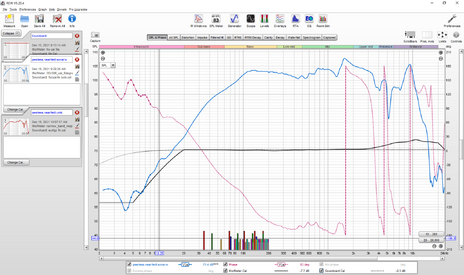

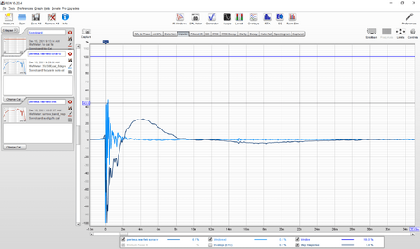

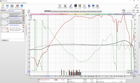

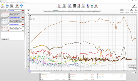

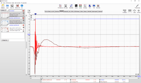

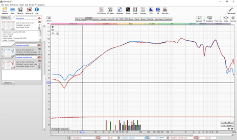

Umik-1 cross spectrum lab calibrated,vs sonarworks xref20+focusrite solo 3d generation.measurement nearfield,driver peerless 5inch,in box.blue sonarworks,red umik-1

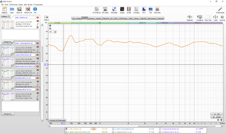

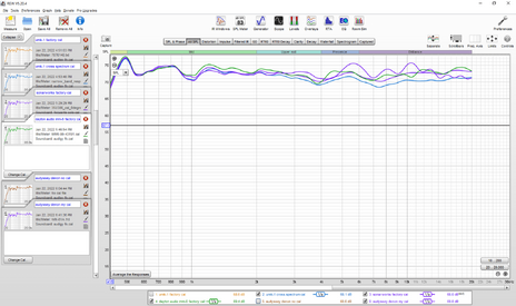

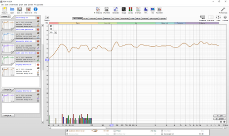

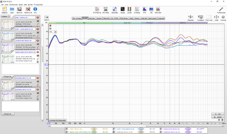

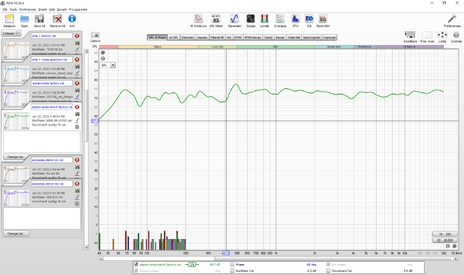

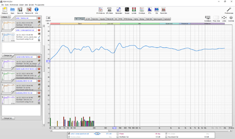

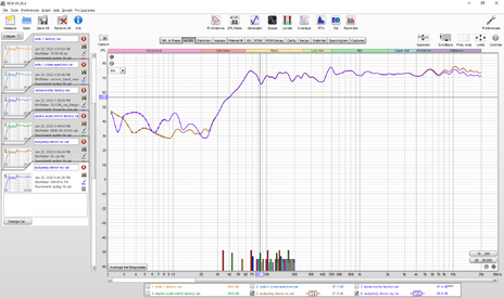

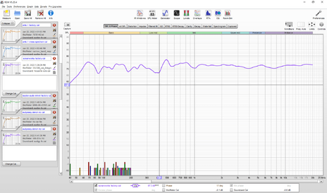

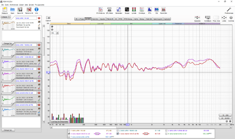

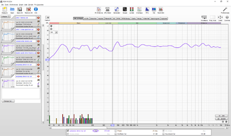

Calibrarea laboratoarelor cu spectru încrucișat Umik-1, față de calibrare din fabrică, față de sonarworks xref20, calibrare din fabrică a microfonului, față de calibrare din fabrică Dayton audio imm-6, fir construit pentru placă audio pentru laptop, față de microfonul Audyssey Denon , calibrarea mea.
just comparison between microphones.
@goginux it would be interesting if we could actively look at those, comparing particular ones with others etc. Could you post the .mdat?
I found them, I thought I deleted them
Thank you goginux. It seems all of them are doing a good job, and just one disagrees by a noticeable number of dBs at HF.
I only use umik-1 and sonarworks + focusrite, with the 2, audyssey and dayton I did a few years ago when I didn't have these.

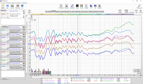

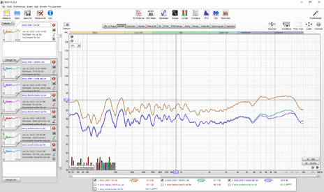

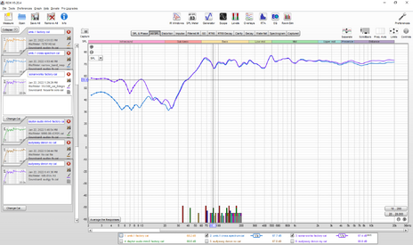

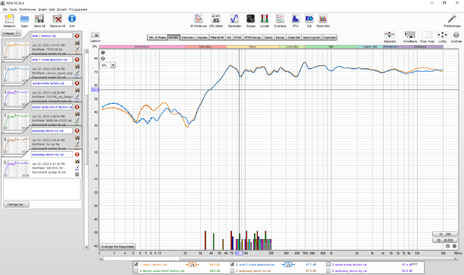

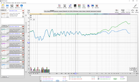

measurements with calibration file and without calibration.speaker sony ssb1,vifa midbass,seas tweeter.

I have a UMIK-1 that was calibrated by Spectrum Labs that measured the exact same as another unit that came straight from miniDSP. I did not use moving mic... not sure you could really get an apples to apples comparison with averaging. I use a program to center the mic, and mark the mic holder and measure tip to ceiling to be sure I get it as close as possible. You might see .5dB difference here and there, but for the most part it should be close.

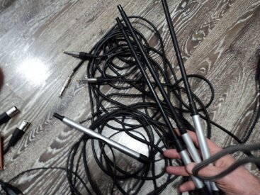

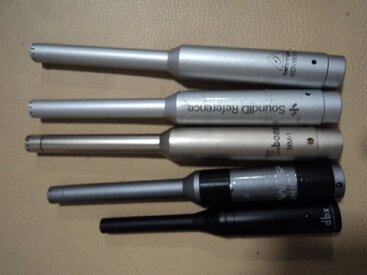

I have 6 microphones bought and some built by me,dbx rta-m and umik-1 are calibrated to CSL,ecm8000 is calibrated at dr. jordan in germany,xref 20r5 is calibrated by the factory, as well as dayton imm-6.I will make some measurements for comparison.
