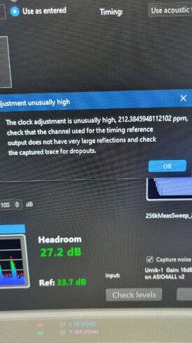

Heya folks
Can anyone guide me towards what this error means and where to look for it?
It usually only happens when i use custom wave doing measurements.
The speakers also randomly crakle, im running with the marantz SR7015, the gfx card is an 3070, im using the front hdmi port "aux" because my cable isnt long enough to reach the back, my pc is in one end of the room, avr in the other, i did read that could also cause problems with a long cable (its 5m), but i cant move either of them any closer, anyway of making it better? higher quality hdmi cable maybe? different port?
Its not always, but often it comes up with this one.
Im running the latest version of rew

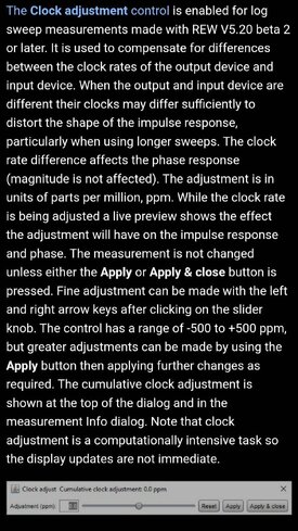

I found this image also explaining what it is, but im a total rookie with all this, so i dont really understand what it means.

The clock adjustment error message and crackling probably both have the same cause, data being lost. Increasing the ASIO buffer size may help, but if the issue is poor signal transfer due to the HDMI cable length (quite likely) you'll either need a shorter cable, some form of active HDMI extender, or put the WAV files on something your system can play to remove the need to use the PC for playback.

just ordere a hdmi booster, but another thing, i found the clock adjusment tap under impulse, there i can set it so it shows 0.0, unless its past 500 of course, isnt that the way to make my measuments acurate?
6,648
No, that's the wrong thing to do. REW works out the clock adjustment by looking at how many audio samples there are between the timing signals and comparing it to how many there should be. When the replay and capture devices are different there will be some difference in their clock rates leading to different sample counts, but the difference should be fairly small, usually below 50 ppm. Big differences are more likely to be due to data loss, which cannot be corrected.

REW applies the clock adjustment itself, the manual option is not something you should use

This is getting very frustraiting, so i tried with 2 shorter cables with a booster inbetween, i long pricy heavy duty one, its still giving me the error, dosent matter if u se rew`s own sweeps or custom ones.
Weird thing is, when i get the error, i can run the same sweep 3-4 times and by the 4 time, it gives me one under 50, other times the sweep work fine the first time. I really wanna figure out whats causing this. :(
If i run sweeps without timing reference it dosent seem to give me the error.

@Michael_B are you using the onboard HDMI output or the MSI 3070 HDMI output to connect to your AVR? If you are using the MSI 3070, try using the onboard HDMI output and enable the Intel Display Audio as the output in the ASIO control panel.

aah theres an option i didnt think about, yes ived been using 3070`s hdmi..

It seems like (still need more testing) that unticking hardware acceleration when re-installing REW was the culprint of the high ppm

I fixed the high clock by unticking hardware acceleration when installing.
