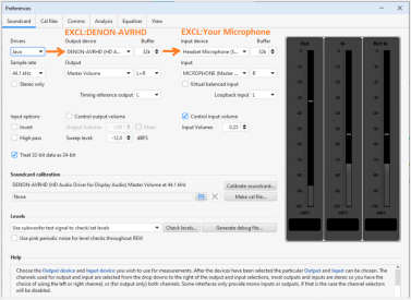

What type of mic are you using for these measurements?
Your settings indicate a 'headset microphone'. What is this? Do you have a calibration file for this mic? If this is some sort of gaming headset mic then it is completely unsuitable for measurement purposes and you need to obtain a mic specifically made for measurements such as a UMIK-1 or similar.
I don't think this is an acoustic issue. With your previous measurements, I have already checked if poor microphone centring was the culprit. It was not. I also tried inverting the phase and summing. This was not the culprit either.
After viewing your video, I suspect this is due to some kind of processing in your AVR when it receives multichannel input.

Also, please confirm if you are using WASAPI Exclusive given that you are using REW in Java mode. As John says, the output should be labelled EXCL.
As already mentioned, a headset microphone is not suitable for taking audio measurements. Still, using an inappropriate microphone does not explain what is going on here.
I forgot to include a screenshot, but the input and output are listed as EXCL, and are actually the only devices visible in the list.

Are you saying that to test each speaker, I have to go to the soundcard page and select it there, not just by selecting it at the measurement window, like I do in my video?
No, just don't leave the settings as default and use the EXCL device entries where available. Note that if you disconnect a device while REW is running the setting is likely to be lost. Your bass issue with stereo input is likely to be due to processor mode selection, your speaker settings (small/large) may also be a factor.
