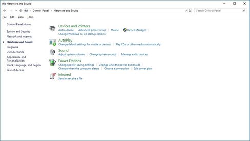

Right click on the Windows Start Button and select Control Panel, then select Hardware and Sound and then Device Manager.
got that and I need to sign on as administrator before I can change settings. Trying to get that window to pop up

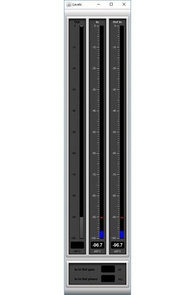

back at it. This and a debug file. Thanks

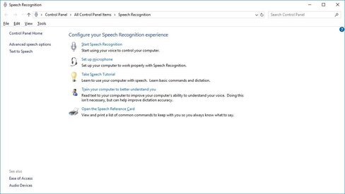

And the latest
I can't figure out how to change this

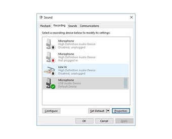

The UMIK is still not appearing. Do you have devices showing in the Windows Recording and Playback devices lists now? Is the UMIK there?

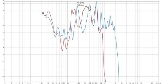

talking into mic.
Speaker talking to Mic. Still, haven't found UMIK mic in recording files. This look contaminated. I also hear the pink noise for a second or so during the recording.

Have you selected Microphone (USB Audio Device) as the input device and MICROPHONE as the input?

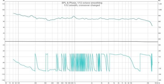

Well heck. I was just informed that measurements are taken with Pink Noise, not music. Heres a measurement with PN only.:hide:
They are not taken with Pink Noise or music. The measurements use a log sweep, a signal that starts at a low frequency and sweeps up to a high frequency. There should not be any other signal. It is possible to use a pink noise signal to look at the frequency response on the RTA, but that does not produce phase data or an impulse response.
Your preferences screenshot shows you have a cal file (63636...) loaded as the soundcard cal file. There should not be a soundcard cal file when measuring with a USB mic, only a mic cal file which appears on the Mic/Meter tab. Remove the file on the soundcard preferences tab and load it on the mic/meter tab instead, that way REW should be able to use the sensitivity information in it.
The good news is your measurement looks normal, though there are some severe resonances (e.g. 70 Hz) and a lot of background noise.
